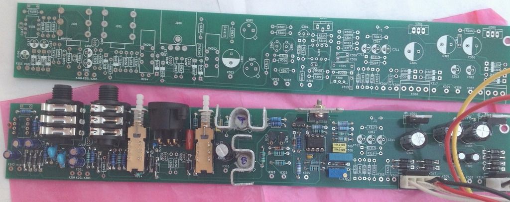

Postby Yazoo55 » 14 Jan 2017, 14:42
I've been working away and done the top board. I used a Chinese fabricator and I am pleased with the results, though there were a couple of mistakes I made. :roll:
I ended up having to add a couple of jumper wires on the back of the board and I had to very carefully enlarge the holes for the power pins which I had set too small. I haven't been able to resolve the issue relating to GND2 and the Mute circuit so I've ducked the issue for the moment and added a jumper to the board so I can come back to this. I've left the components for this off the board. I don't really understand the purpose of the Mute circuit so if anybody can help I would be grateful. If it is optional, I'll just leave it.
I've assembled the board and tested the power supply. I am using a spare ADA MP-1 power transformer I have. This is a photo of the assembled board.
I am planning on doing the main board next but this time I'm going to double-double-check it before I send it off.

Postby Yazoo55 » 02 Feb 2017, 23:11
I have got the main board ready to send off for manufacture now. I still have a query about the wiring though. I've been through the schematics and layout guides and I can't see a connection from the signal ground to the chassis. There is a bus wire which is soldered to the top of all the pots and this is connected to the chassis but it does not connect to any point on the circuit boards. Is this correct?
As a postscript, I checked out the GND2 issue by recreating the power circuit for the mute function with a spare bipolar supply I have. As I understand it, when powered on, this turns off the mute function to all the outputs by supplying around -14 volts to the base of the three FET transistors. In my test circuit GND2 is connected to tha main ground and it all worked fine. I saw the negative voltage as expected as well as the standard bipolar outputs.

Postby Yazoo55 » 24 Feb 2017, 19:52
OK, I've done the main board and assembled it for testing and it actually works! I just need to finish putting it into the second-hand KVM rack I bought. I checked the plate voltage to the 12AX7 and it varies from 16 volts up to around 250 volts, depending on how you set it. At 16 volts, it breaks up much quicker. At higher voltages, it stays cleaner.
I did make a couple of mistakes in my Kicad files, the worst being power connectors on the power board and I had to jumper these. :roll: I also got the orientation of a transistor wrong but that was easy enough to sort out when I soldered it in. Definitely a learning experience but well worth the effort.
