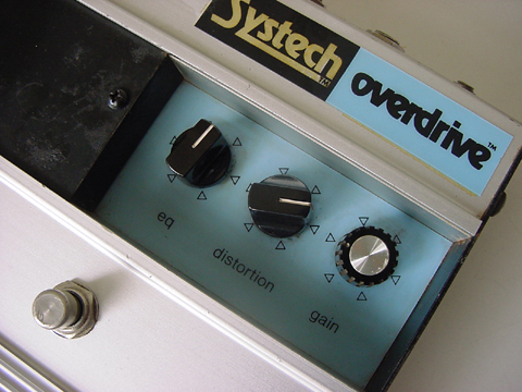

Borrowed this one from a buddy and there doesnt seem to be much info on it anywhere. It's certainly not an overdrive in the modern sense of the word. Its buzzy and fuzzy and the EQ sounds like a wah. This is my first attempt at tracing, so hopefully i'm doing this right. Here's what i've got so far:
I've got all of the component values listed out, but left them on my bench at home. I can add them shortly. The IC is a dual op-amp, as you could probably figure out by looking at the schematic. Pots on the schematic are Gain, Distortion, and EQ (L to R). I think the only really goofy thing that jumps out to me is the orientation of the FET in the buffer. You'll notice that its inverted in the schematic and the SOURCE is tied to the positive voltage with the drain to ground via R6. This seemed weird to me, but I certainly dont know everything. That FET is a 2N5458, I believe.
Also, I dont quite understand the power supply and the role of the NPN in it. Anyone have an explanation?
Please check out the schematics and let me know if you see any glaring problems. Otherwise i'll need to verify this soon by building it.
