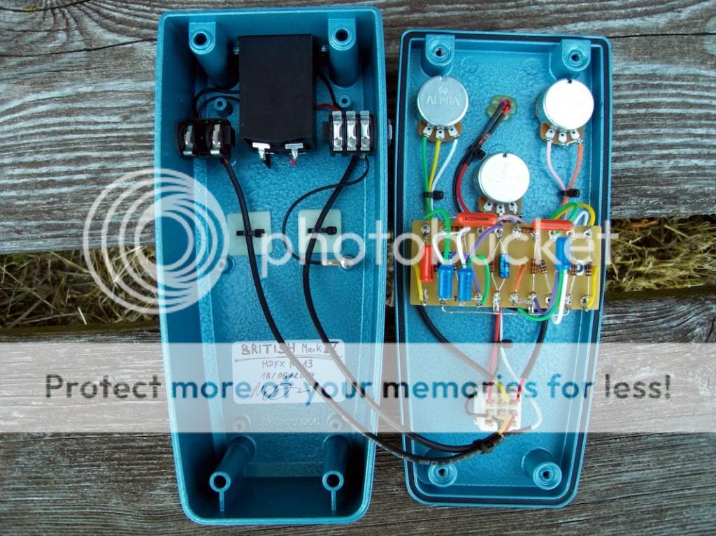

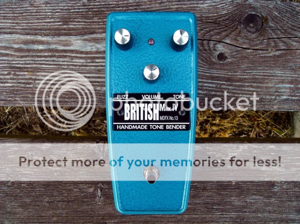

Here´s my latest one. Point to point MK IV.
Full album:
https://s573.photobucket.com/user/contr ... 0Mark%20IV
Full album:

Where did u get that cute enclosure?
