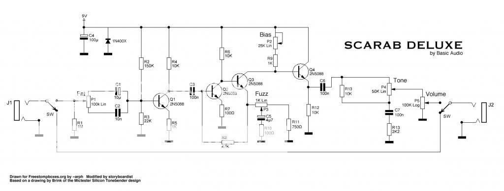

IvIark wrote:Yes that looks like the way John described it, or at least that's how I understood it.
Cool. Maybe John will chime back in and confirm. Thanks for you input lvlark. Oh, and thanks for your blog. Without it I would not be building pedals and would have zero soldering skills. :thumbsup

I meant Q4, correct.
Remove C8, put R13 between C7 and ground.
R7 should be 100 ohms.
100 ohms between C5 and ground.

Thanks John! Here's the final schematic.

Why is C1 so big? Wouldn't 1µF sound exactly the same? I don't like electrolytics in the signal path...

1uf might be enough for you. The cap stores energy as well as passes signal at all frequencies.
I like the sloppiness of 10uf. My goal is to make it as tight and responsive with the .01 and then sloppy
with the 10uf. So you set the FAT knob as you like. 10uf has a good bit of thump to it...

So does Q4 base and collector connect to the bias resistor? That looks peculiar to me.

Why not replace the tone pot with a 10k and leave out R13? (or am I missing something? it's still early)

IvIark wrote:So does Q4 base and collector connect to the bias resistor? That looks peculiar to me.
Just going back to this, I'm assuming the Bias pot just connects to Q3 collector, and Q4 collector actually connects straight to the supply. That would then be in keeping with the Hot Silicon.
I thought it looked odd, and also assume the Q4 collector is only connected to +9v. If the collector and base were shorted, wouldn't it just be a diode?

Here's the schem again, hopefully in its final form, with the Bias control moved to effect only Q3.

~arph wrote:Why not replace the tone pot with a 10k and leave out R13? (or am I missing something? it's still early)
The 10k/.1/2k2 is the low pass filter. The 50k pot pans between a low pass and tone network bypass (for the most part)
Imagine the big muff tone network with only the low pass side.

I think what ~arph was saying is that because the 10K is in parallel with the tone pot, it's just like having an 8.3K tone pot, so why not just omit the 10K resistor and use a 10K for the pot.

IvIark wrote:I think what ~arph was saying is that because the 10K is in parallel with the tone pot, it's just like having an 8.3K tone pot, so why not just omit the 10K resistor and use a 10K for the pot.

Postby John Lyons » 03 Jun 2014, 23:36
Ok, I see it now. Paralleling the pot changes the taper as well.
Cheaper to use a 50KB pot rather than a 10KC...
The 10k resistor is only a couple cents. A 10KC pot is $1.50 or so.

Yes, you can influence taper, but shouldn't the 10k be connected to the wiper instead of the low side of the pot to simulate a reverse log action? The way it's connected now just makes the 50kB pot a 8.3kB pot.
