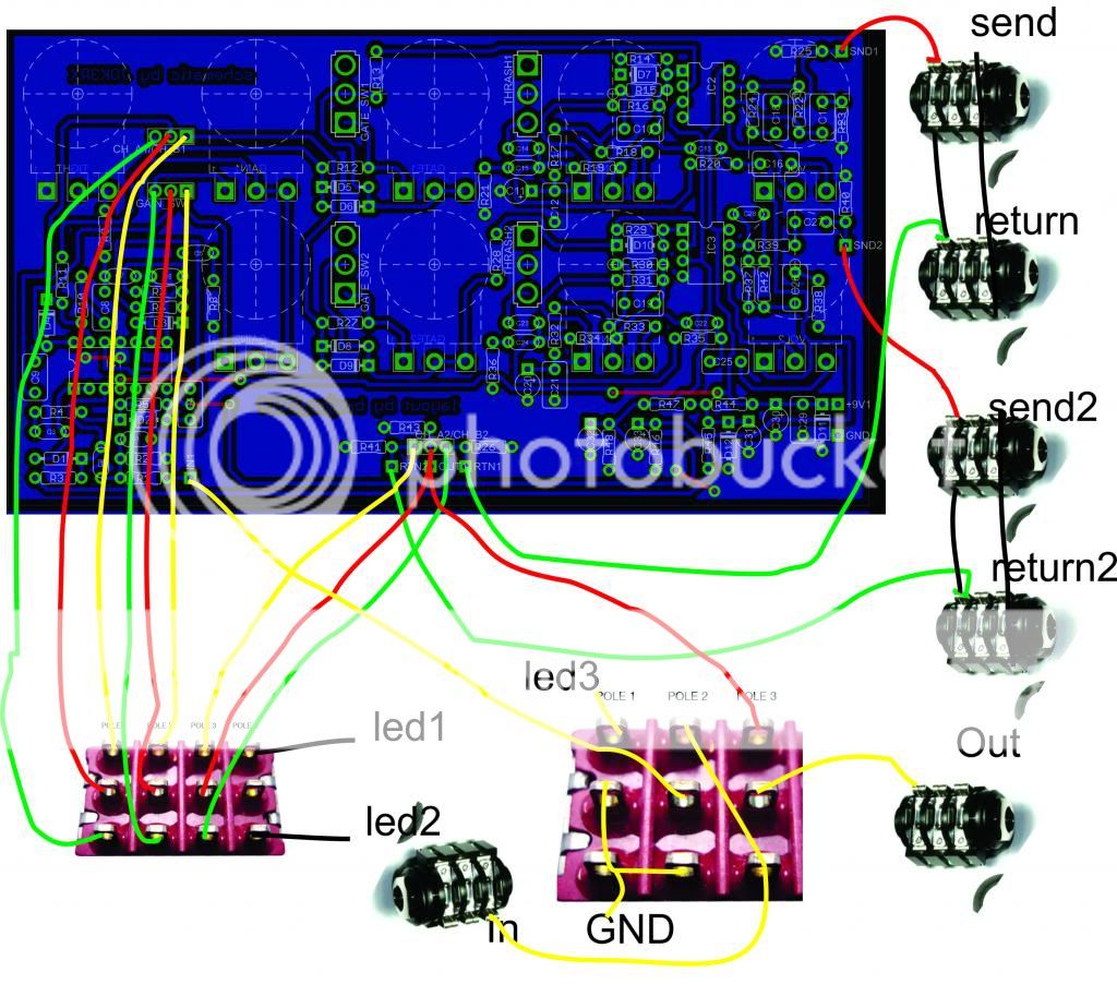

@ brejna
Checked the pdf and saw a 4PDT in your partlist.
Is this correct? :scratch:
Could I do it with a 3PTD this way?
https://app.box.com/s/n0pmsle75rngzdofi9yv
Allso the gain switch. Isn´t it a SPDT?
Want to order the parts.
Thanks for that awsome work!

Post by brejna »
Nicht Bernd wrote:@ brejna
Unfortunately it is 4pdt, you can use 3pdt but without LEDs. Gain pot is meant to be changed with that 4pdt and be carefull with the wiring, all square dots should be on the one side of switch.

Post by GodSaveMetal »
Mr Brejna please post the external connections with the 4pdt and others jacks, of the Double Tight Dragon thanks man!!!

Post by brejna »
GodSaveMetal wrote:Mr Brejna please post the external connections with the 4pdt and others jacks, of the Double Tight Dragon thanks man!!!
Here it is :)
Thanks million thanks Mr. brejna; it´s awersome incredible!!!!
