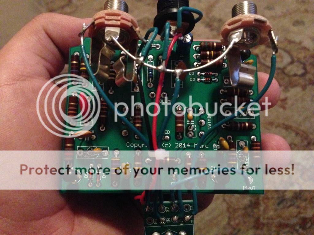

When I saw R7 was only 120r in the schematic, I had to check the photographs.
It seems Mark really did use a rather low value for the limiting resistor. :shock:

Cub wrote:Thank you both so very much for this ! :applause:
Yea, it was weird. Totally threw me off for a minute or two, but it's definitely correct. Anyways, I did cock up one value. The collector resistor on Q3 should be 18k, not 15k. About to start a clone layout, so I added a mids DIP switch to the schem. Omit it and the two related caps for the stock circuit.

Postby Skreddy » 26 Jul 2014, 07:17
All resistors are 1/2 Watt carbon comp except for power supply intake and LED current limiter.
All .1uf' caps are multilayer ceramic. They sound like the oldschool ceramic discs that aren't made any longer. The .1uf ceramic discs you can get generally aren't as full sounding.
The 120R resistor inline between the sustain pot and Q2, normally 8.2k, permits a more trebly and aggressive sound when you turn the pot to max. Kinda like a secret setting. Very cool. Note: the original Mayonaise did not have ANY resistor here at all (seemed redundant to me at the time, so I designed it to carry the signal straight from the cap to the base of Q2).
Yes R18 is 33k not 39k (as corrected by the 2nd schematic).
Note C4 and C6! They're .22uf instead of the normal .1uf. Why? C4 adds more bass, and then C6 clips more bass, resulting in a creamier tone while maintaining a neutral eq footprint (the additional bass is converted to fuzz rather than left in the signal).
Note: Matt and Mark
It's considered proper to either entitle or annotate your schematics with something that suggests that this is a derivative work as traced BY YOU in order to avoid representing your work as if it were actually mine. It may or may not be 100% accurate, but it's still best to differentiate your work from that of the person whose design is being traced. That's why most clone schematics have made-up names given to them instead of the original trademarked name. That's not absolutely necessary, but it is good to at least mention that this is not an actual Skreddy Pedals schematic.

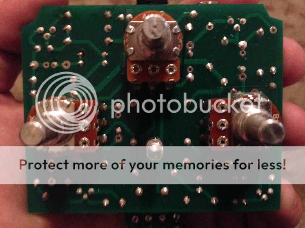

Postby mmolteratx » 05 Aug 2014, 23:00
Here's my layout (not verified, but I'm 99.99999% sure it's good). Note, absolutely zero commercial use allowed. If I find anyone selling these, I'll fly to your house and kick you in the nads. And you may or may not find yourself in trouble.
A few notes pertinent to the build:
Use the schematics linked to on the OSHPark page.
The board is designed to be used in conjunction with my 3PDT daughter board, which holds the main filter cap
Caps are all spaced for TDK FK28 MLCs, but any standard 5mm spaced caps should fit
Transistors are original SE4021s, but you can use anything really. Just check the pinout
Muff - https://oshpark.com/shared_projects/js3WRmMT

Postby Skreddy » 06 Aug 2014, 01:43
mmolteratx wrote:Here's my layout (not verified, but I'm 99.99999% sure it's good). Note, absolutely zero commercial use allowed. If I find anyone selling these, I'll fly to your house and kick you in the nads. And you may or may not find yourself in trouble.
[ Image ]
Switch - https://oshpark.com/shared_projects/Buk2PeKO
What's the lead spacing for those resistors? 12.5mm is what you'll want for 1/2 W CC's.

Postby mmolteratx » 06 Aug 2014, 02:40
[ Image ]
10mm I think. Was as big as I could go in a 1590B. Might redo it in a bit with 12.5mm.
