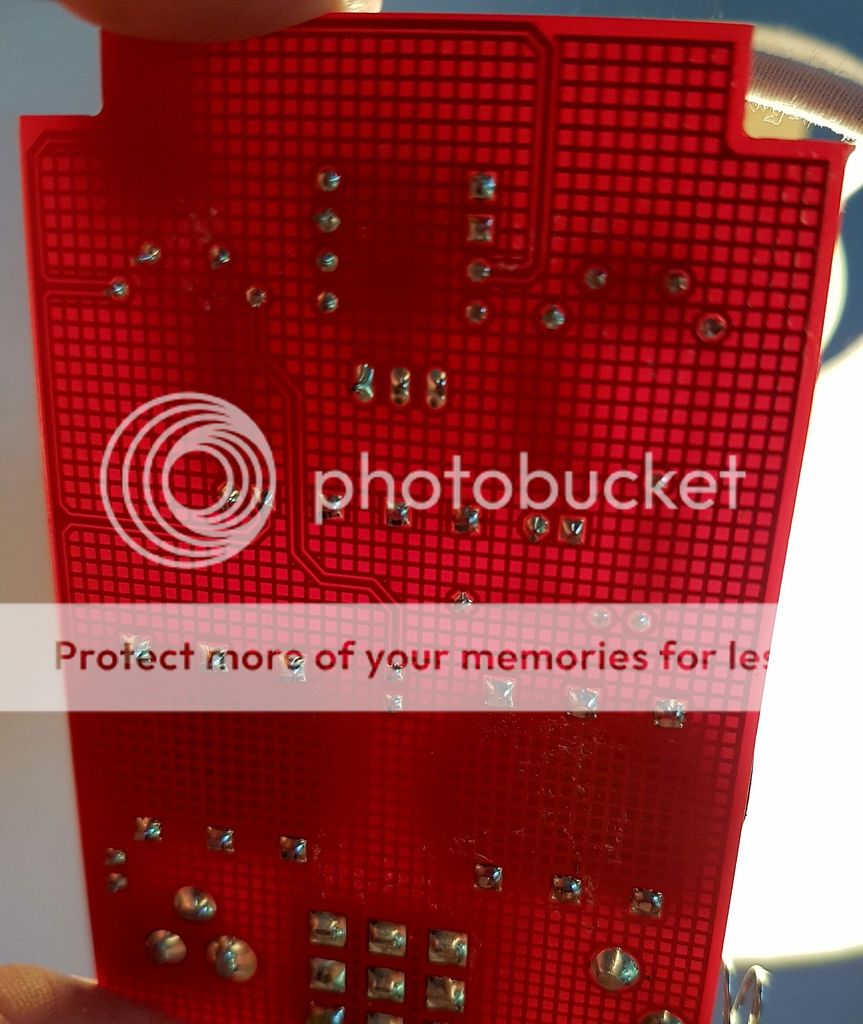

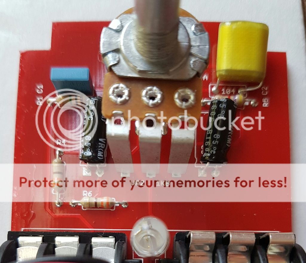

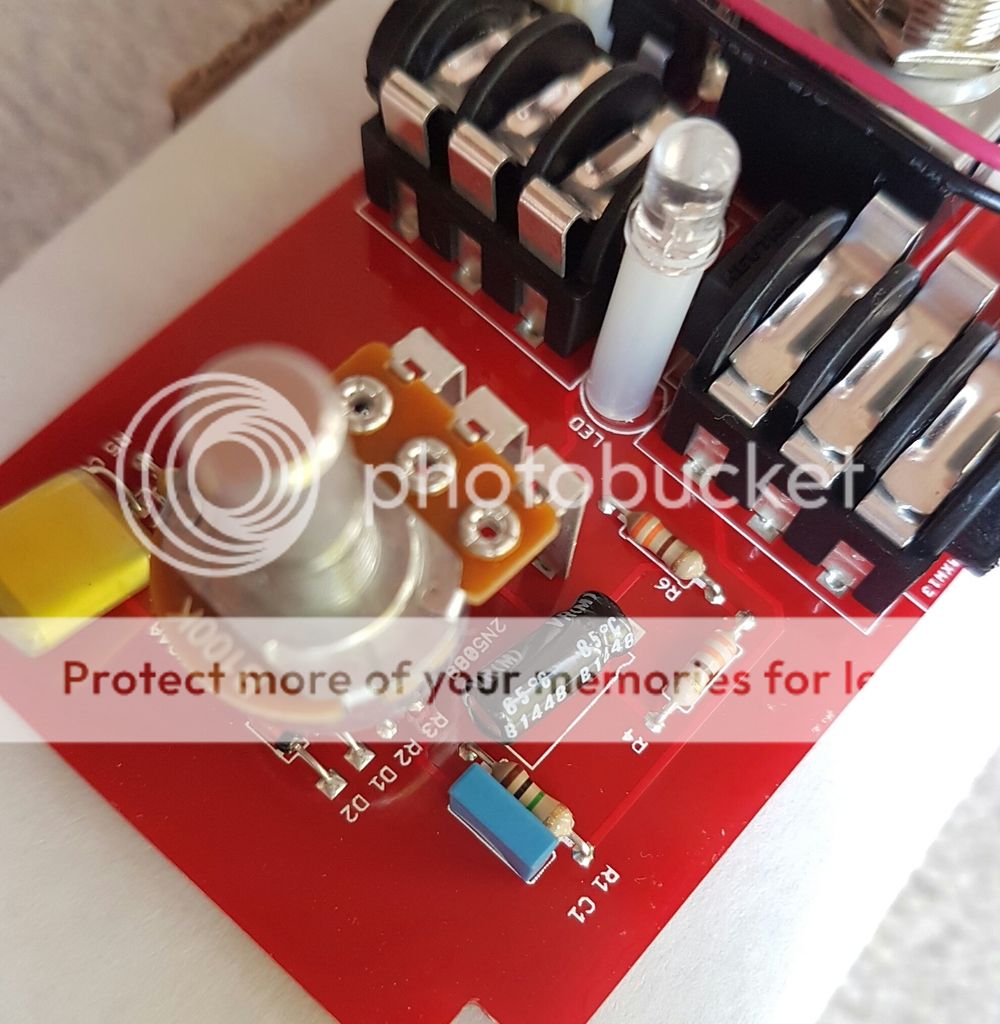

Hi All
After years of being on this pedal forum among others, I finally have something to repay the favour. It's not the most technical but I'm pretty sure the Lovepedal Champ hasn't been posted up here yet.
Q1:2N5088
D1+D2: 1N34A
POT (Volume): B100K
Electro x2: 47uF
C1: 47n?
C2: 0.1uF
R1: 1M
R2: 3.3K
R3: 2.2M
R4: 330ohm
R5: 4.7K
R6: 330ohm
Looks a lot like a Woodrow with a couple of extra resistors. Not sure what is going on with R4 and R6 but someone will probably be able to sketch that out. Sounds better than a Woodrow however, probably due to the diodes. Not a lot of grunt but not bad tone considering.
Enjoy!

Alright pullled it open again and the mystery cap is 22n. I also took a pic of the transistor as I neglected to do that earlier. I can't see any writing on the diodes but I'm pretty confident they are 1N34A by the sound. If everyone is happy with that then I think this is pretty much done? Still enjoying the tones I must say but I'm a one knob, one transistor kind of guy. :D
