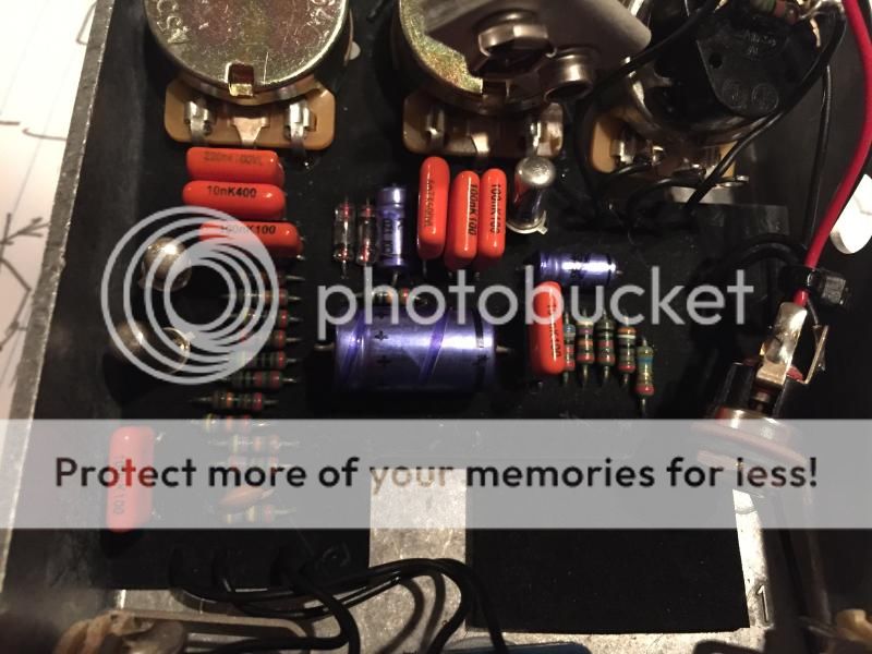

Postby mmolteratx » 18 Oct 2014, 05:11
Accidentally broke the drive pot on mine and opened it up to repair tonight. Figured I should probably reverse it while it was open. Build quality is great, but TBH, it sounds like complete ass with the drive knob above 3 o clock or so, and it doesn't have much gain below that. Not worth the new price, or even the average used price honestly. Only got it because I took it in on a trade. Q1 is unknown. It's in a flanged package like the AC128s, so it's a germanium, but it isn't labeled, and an NPN would make more sense in that position based on the values, IMO.

Postby deltafred » 18 Oct 2014, 09:58
mmolteratx wrote:Q1 is unknown. It's in a flanged package like the AC128s, so it's a germanium, but it isn't labeled, and an NPN would make more sense in that position based on the values, IMO.
Based on the voltages I would say it was a PNP, 200mV is consistent with it being germanium PNP.
If it were NPN a VBE of 5V is way too high.

Postby tube-exorcist » 18 Oct 2014, 11:24
I am missing (at least) a capacitor between C7 and R12/13.... just saying.

Re: Telenordia - TA-100  [traced]
Postby mmolteratx » 18 Oct 2014, 17:45
:thumbsup
You're right. Fixed.
tube-exorcist wrote:I am missing (at least) a capacitor between C7 and R12/13.... just saying.
D'oh. Dunno how I missed that one. Also fixed. Had it on my hand drawn copy and it didn't make its way to the electronic one. Here are pics of the top/bottom.
