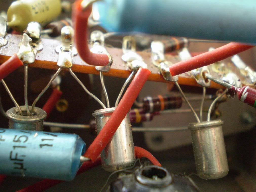

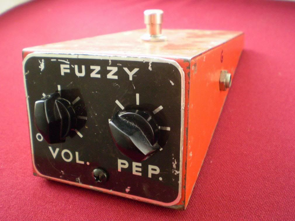

looks like a Fuzztone clone, inside + out, but is it a WEM prototype? Anyone seen trannies like those before? American?

I would doubt that it's American made....it looks like it's using British made components (Mullard, Phillips, etc..).

Hard to know, but it doesn't seem very WEM to me. "Pep" is an old fashioned slang word not exclusive to WEM. I've been looking for a WEM Pep fuzz for a while.

ok, yeah - I didn't realise mustard caps were specifically Philips, but are you saying those are Mullards? I haven't seen them in that case style before.

It's probably a Pep Rush fuzz, before they were made by WEM. The "pep" has nothing to do with slang, but with the nickname of the guy who built them: Pepe Rush.

Cool factoid - I do remember now, from an article a guy called David Toop wrote on the Pep box. It would still have been a play on words, though, though. Pep as in "pep pill" and "pep you up" - because the user would not have known about Pepe and the label would otherwise have been meaningless.

I am missing the WEM connection evidence..... "Pep." written below one control isn´t enough for me.

Pep Rush made fuzz pedals before they were made by WEM, so a WEM connection is not necessary. I'll try to contact David Toop (writer of that article) and Pep Rush himself...

The WEM version is massive and I think has wood in the construction somewhere. Its the usual Charlie Watkins insanity. According to Toop the WEM versions were silicon. I want one.

I tried building it from AG's schematic at the weekend - no joy - maybe it needs v high gain trannies?

u ran it at 3v and positive ground? I've not tried the schem yet, I'd be suprised if it wanted very high gain transistors, can u check any of the values any better with those ebay pics?

High gain Si-trannies in the '60th have app. 200 hfe but the trnnies on the gut shot they look like European Ge-trannies. You must rebias the trannies if you use other types or trannies with different hfe, no mater if they are Ge or Si.

yeah: 3V pos gnd, but I'm just rubbish so I probably made a mistake - my first thought was to check the values on the new pics, but this was just my quick weekend experiment, I'm not really motivated to put more time in. I've just about reached saturation on the fuzz front (tee hee) but was intrigued by this one as an early variant and i like the crap early fuzz sound. I use 2N1305s, approx 80 hfe. But - again - I'm not very good so I probably messed up.

The pictures where I traced the schematic from are much better than these..... one is even the same....

all right! AG's schem is confirmed and working nicely (well, horribly, but in a nice way) - I looked again and realised I missed a trace cut on my layout - it sounds quite beefy and Tonebender-ish to my ears - probably because I used a bigger output cap, I didn't have the right value to hand, but I used a socket, so all is well. I haven't done a full test yet or tried many different trannies - just happy to get it buzzin' - Thanks a lot, Gottfried!
I've got 2G381Ts (as used in the Selmer Buzz Tone) in there for now.
