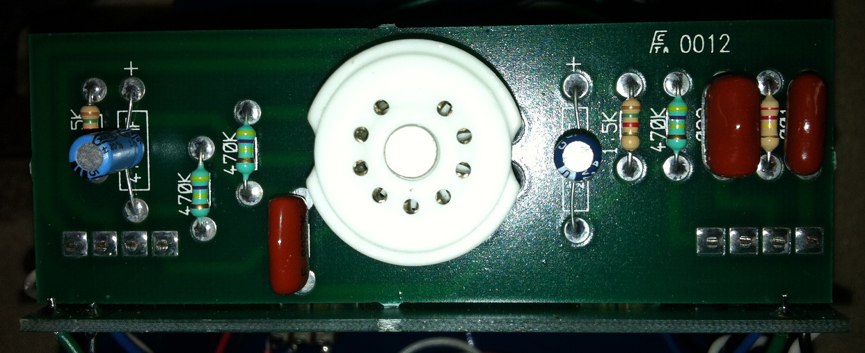

The 470k & 470k voltage divider before the second tube stage looks backwards.
Hey, Bill.Bill_Mountain wrote:It looks pretty cool.
I double checked and that's the way it is!

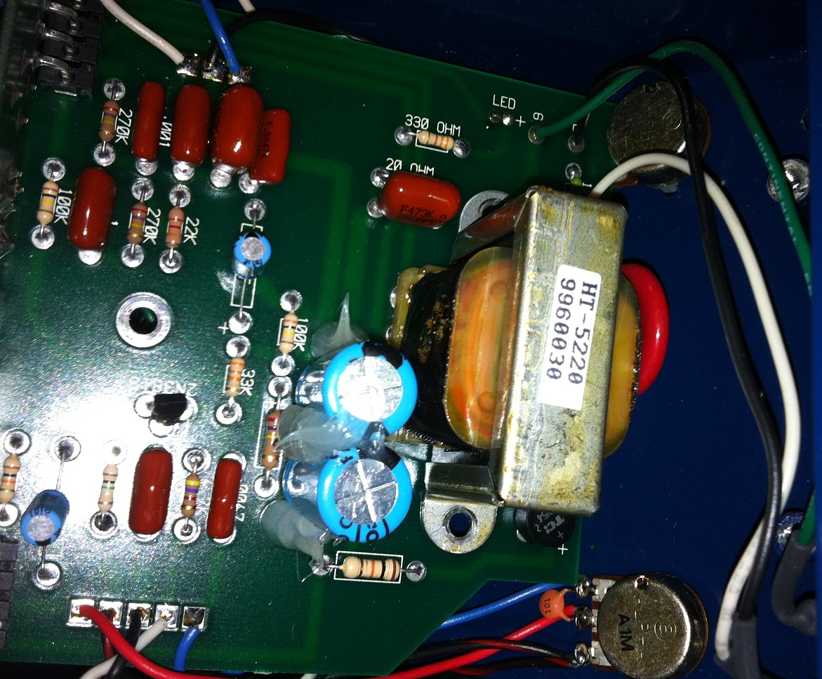

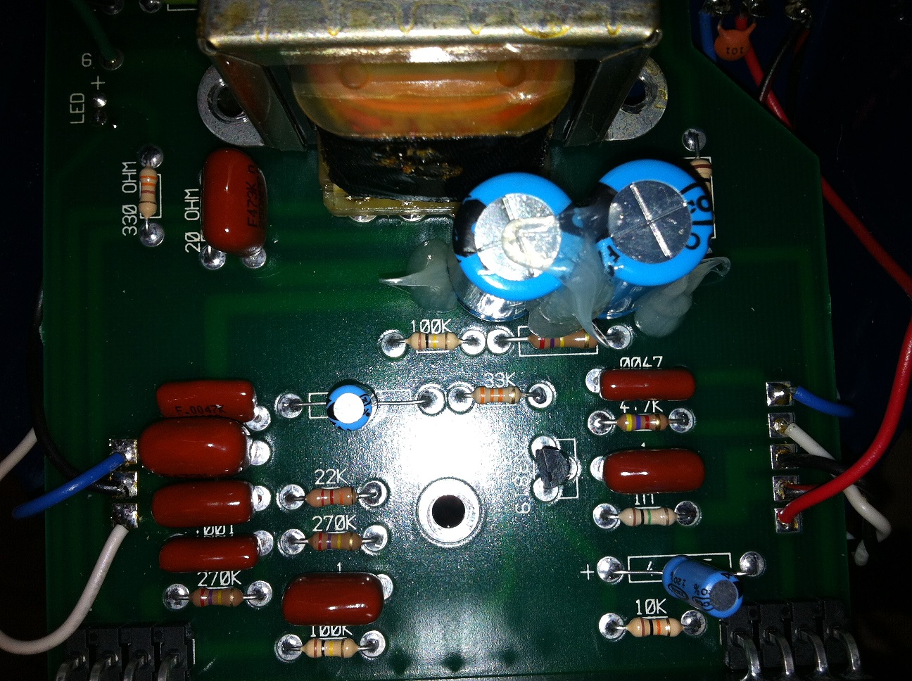

I noticed a 100pf cap in your pictures, on the underside of the board. What is it connected to?

Looks like the 100pf is on the gain control. Makes sense.

Just noticed I got the 470k thing wrong on my prototype, I'll have to fix it and get back to you about the tonal difference. It'll double the signal getting to the second triode as well as making the clipping of the second triode much sharper/crunchier.
It could also explain the excess top end on my prototype- 470k is one heck of a grid stopper and should cause a pretty substantial treble rolloff. It'll be down -3dB around 3k on a 12ax7! It won't be quite as bad on the 6112 with its lower gain and slightly lower input capacitance, but I'm sure it'll sound better with the 470k in the right place.
